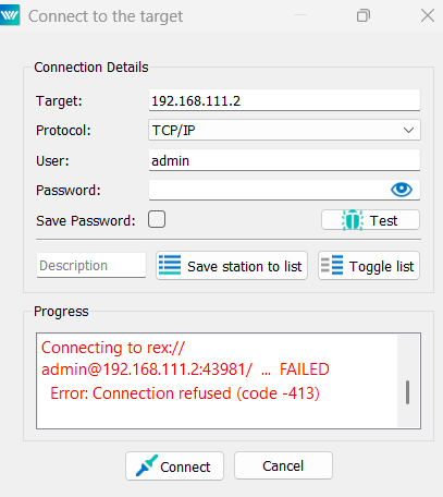

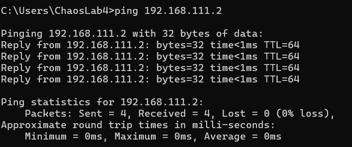

      I am unable to conneect to the rexygen to my Raspberry Pi.

        Check if RexCore is running. I see that you are solving the Python code in another thread. It is possible that your code is not only causing the error, but also causing the entire RexCore to crash. Try connecting to the Raspberry via SSH and enter the command:
        systemctl status rexcore
        Cheers,
        Jan
