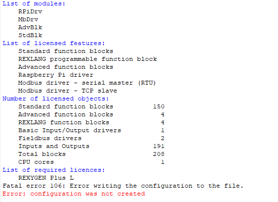

      Hi All,
      What is error 106 that is causing the configuration not to be created?
      I've also had error 103
      It can't be a license issue as I have the required licensing installed.
      Cheers,
      Mike
      M cechuratC 2 Replies Last reply Reply Quote 0
      • M
        MikeyH @MikeyH
        I'm sure how or if it's related but this seemed to go away after I removed the HMI block from the exec.
        Cheers,
        Mike
        1 Reply Last reply Reply Quote 0
        • cechuratC
          cechurat @MikeyH
          @MikeyH Hi Mike,
          This error is triggered when something is preventing Studio from writing to the Project location. Do you have all related folders available for read and write?
          If the issue persists, can you share a minimal project with us? Thanks
          Cheers, Tomas
