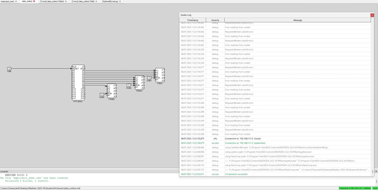

      Hi I am trying to find a way to get my bluetooth sensor(Witmotion WT9011DCL 9-axis BLE Magnetometer Gyroscope) to communiate with rerxygen so I can stream the data into rexygen. I have been able to connect the sensor with my raspberry Pi 4 monacrohat. I then tried to stream the data into rexygen but have been unable to do so. I have attached the my program below. b20b7866-14b5-4b69-9ec5-b5498db19a0b-image.png

        @har Hi Har,
        I'm sorry, but we are not able to debug third-party Python code for you.
        If you made it work under plain Python, then you can send the data to REXYGEN using the REST API. Have a look at "0302-03 REST API Python Bash etc", which sends data to REXYGEN using Python.
        Kind regards,
        Tomas
