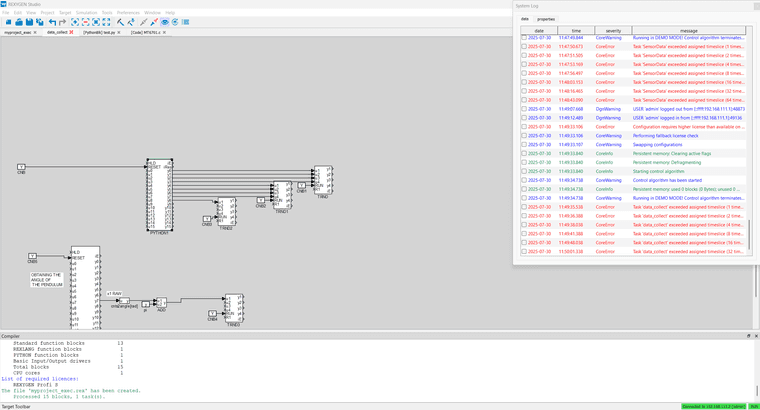

      I am not quite sure what this error means or how to fix it if any knows

        @har Hi har,
        This error is related to the timing issue of the 'data_collect' task. The task takes longer to complete than the allotted time. Based on the image, I would guess that the Python block will take the most time to execute. In your case, I would inspect the timing of the whole project and also the diagnostics of task (Target ->Diagnostics -> data_collect and select the Task tab as shown bellow).
        Cheers,
        Jan
