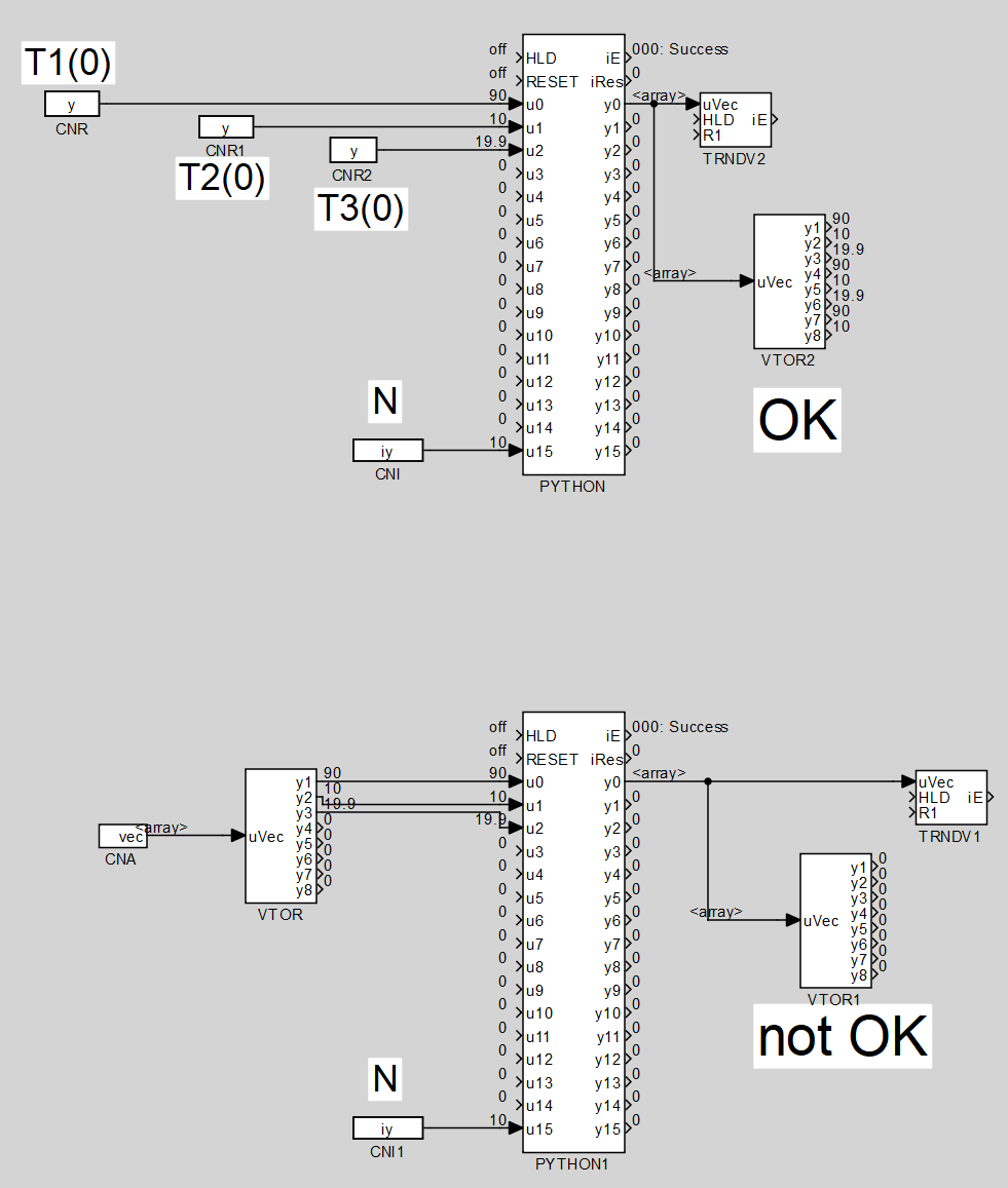

    • Vector demultiplexer VTOR+Python processing
      Hi,
      I'd like to ask why outputs of VTOR1 shows all zeros. Both Python blocks share the same python script.
      It seems like the issue is connected to sources of u0,u1,u2.
      Source project: ex.zip
      Best regards, Stepan
      posted in REXYGEN Studio
