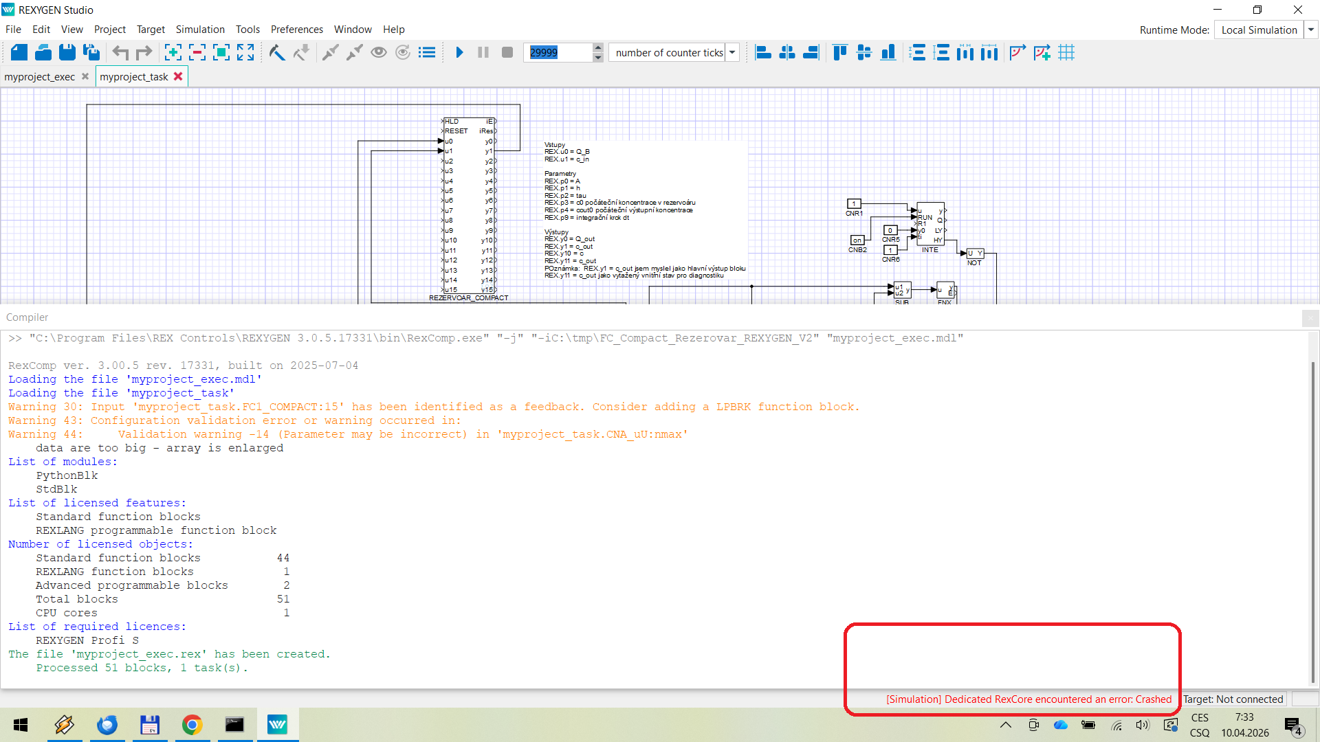

          @cechurat Hi Tomas,
          Thank you for your valuable comments.
          I tried running:
          "c:\Program Files\REX Controls\REXYGEN 3.0.5.17331\Bin\RexCore.exe" -z exec.file=myproject_exec.rex -z simulation.enabled=1 -z simulation.tickmin=0 -z simulation.steps=20000 -z simulation.start=0
          I do not think it was successful, because it did not do anything. At the very least, it was supposed to create f.txt via the SILO block.
          I believe there may be something wrong with this REXYGEN project, because whenever I try Local Simulation within REXYGEN Studio, it reports a RexCore crash; please see the screenshot in the bottom-right corner. As a consequence, the application freezes and I have to kill the RexCore process manually.
          In Real Time mode, it seems to run normally: it shows trends and creates f.txt via the SILO block. There is also a minor issue with overtime in diagnostics, probably related to the PYTHON blocks. I am not sure whether this issue is critical enough to cause RexCore to crash in Local Simulation mode.
          However, I believe this is a separate issue and is not directly related to the original topic of running Local Simulation mode in general.
